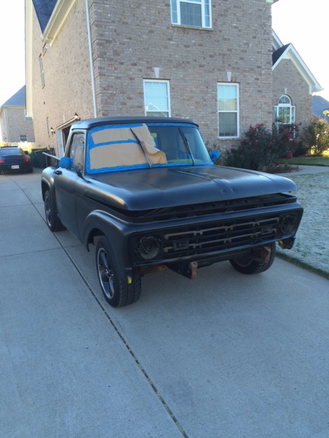

Wheels and adapters installed
Starting to sand..

More paint prep..
In the homemade booth..
The color is not a ford color (gasp) it is actually 799 GM (think 1957 belair)

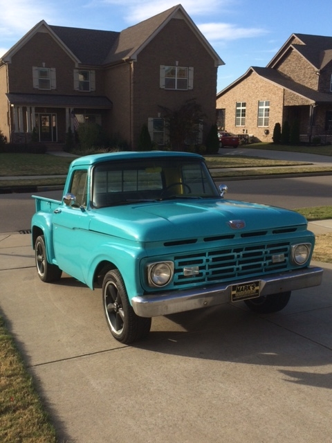

Out in the sun curing up...
Bedlining the sides.. It is a run around afterall... needs to be tough.
Re: 1965 F100 Stepside Build (perpetual project)
Posted: November 17, 2015, 10:46 am
by RRTEC
I am going to get rid of the rest of the yellow paint in the interior this week and then patina the turquoise to show the black in some places.

Started patina work. Leveled with scotch Brite pad then scuffed through with 800 grit. Buffed with 3M compound. Very happy now to do the rest of the truck.

Still working on the patina. Took it for a drive to pick up out Christmas tree, broke necks the whole way there and the boyscout troop we bought the tree from thought it was pretty cool!

Some visuals.. Truck gets a lot of attention!
