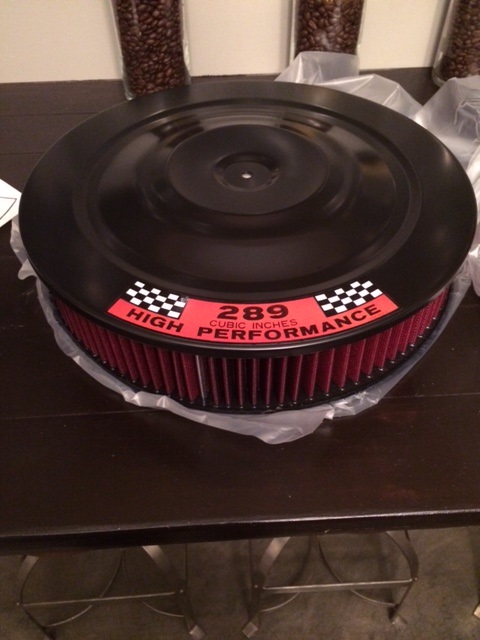

So.. I have been in beast mode when it comes to buying/installing parts. I have been driving the truck locally a few days a week although want to start trusting it more to go further outside my comfort zone..
Here is what I have purchased in the last 2 weeks and am getting ready to install in / on the 289.
1) Torque cam (mild street cam) with Lifters
2) Valve Covers and gaskets
3) Air cleaner with washable filter (also period correct 289 decal)
4) Offenshauser 360 Intake (got a good deal on this or I would have gone edelbrock performer)

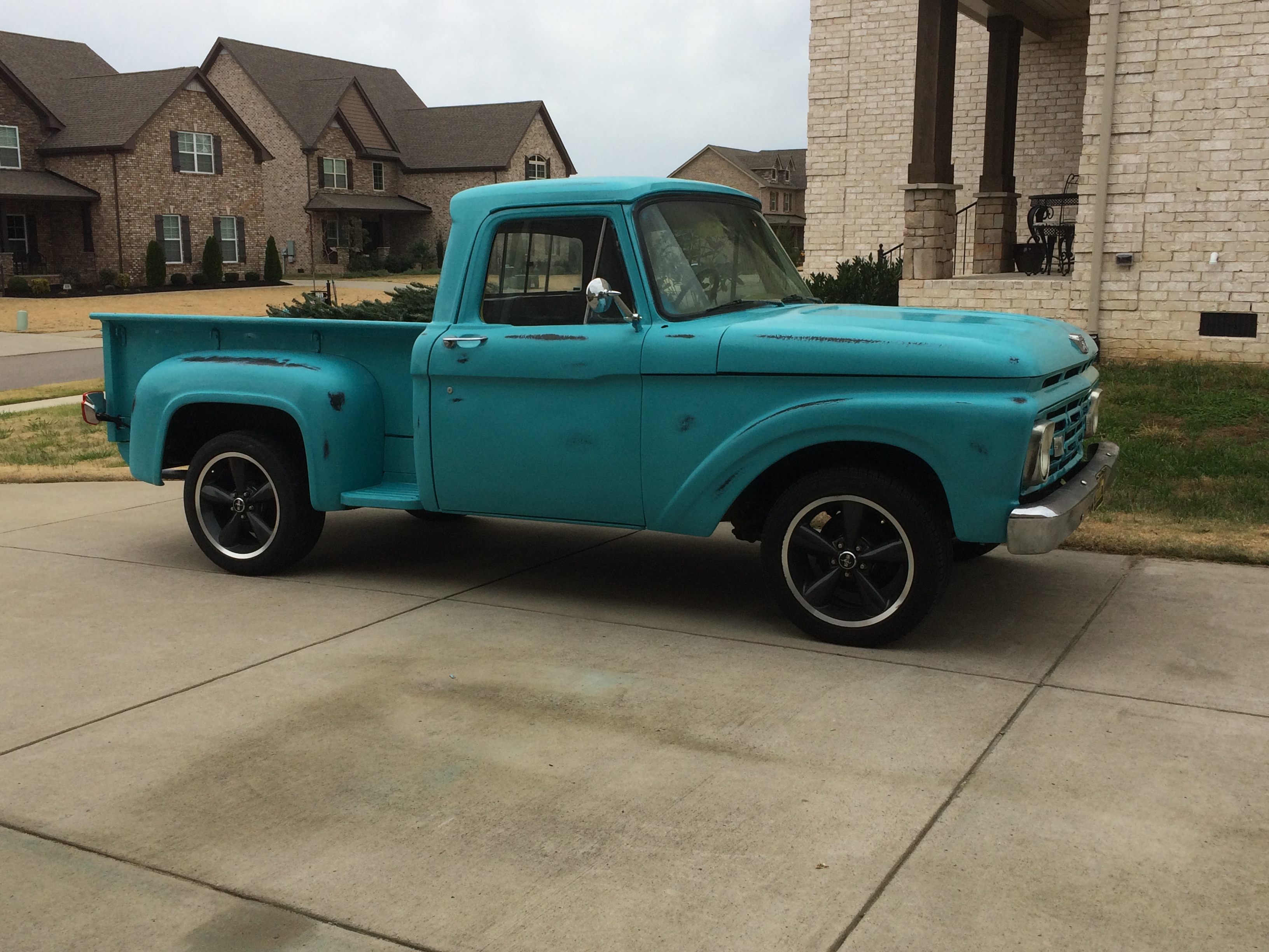

Some visuals.. Truck gets a lot of attention!
- f100bed.jpg (95.11 KiB) Viewed 13281 times
- f100cleaner.jpg (83.54 KiB) Viewed 13281 times
- f100bed2.jpg (94.64 KiB) Viewed 13281 times
