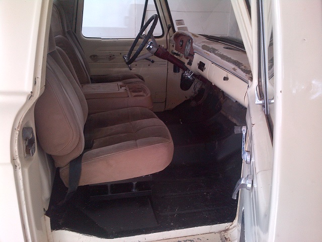

Here I had ripped out the old rubber floor, the rotten headliner and crusty dash pad. I found some 86' For Lariat seats and console in the local wrecking yard. POR-15'd the floor and deloused the rest of the inside.

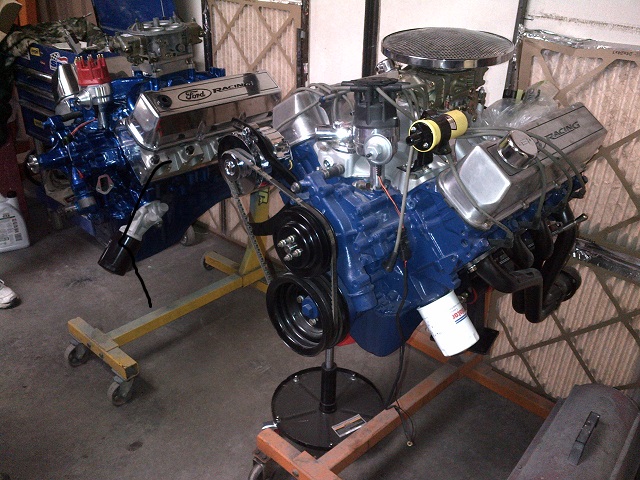

Finally decided on a power train. found a 460 and tranny on Craigslist. tore it down, had a gaulded cylinder. but it was repairable. It's bored .060, has a polished crank, resurfaced block, decked D3VE heads, Flat top pistons for a 9.2 to 1 comp. ratio, Crane RV camshaft, Edelbrock performer RPM intake, Crane roller rockers, Hedman headers, Holley 850 DP carb, MSD Distributor along with a C6 with a 2200 stall converter. Thats my brothers 521 stroker BBF next to it. It's in his 69' Mustang now. Makes over 600 HP : )
