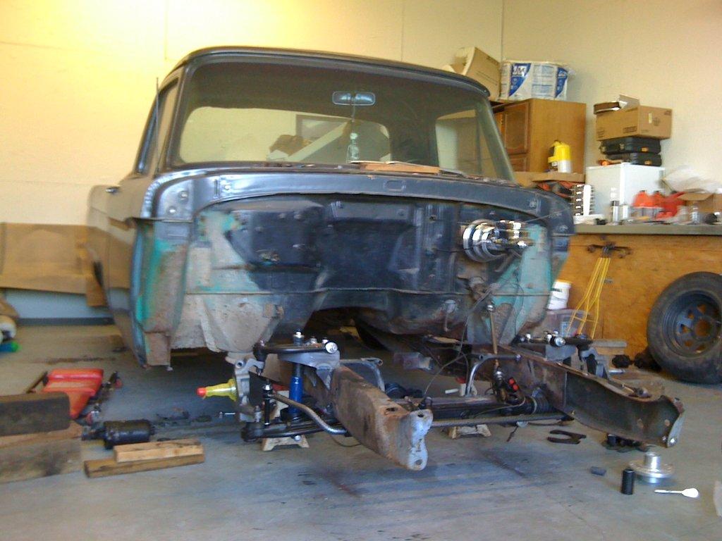

Now we are up to sept of 2011 and decided to pick up where I left off. I moved the truck to another shop and started on a plan. I am not real good at taking progress pics, but will try and do better as I finish before SS in KC. Here is what was placed on order:
Remainder of the kit:
Front Sway bar
2" drop spindles
A-arms
Hub
disc brakes and Calipers
power rack
MC and booster
Trans mount - because I lost the original in the move. The motor fit the original motor mounts and trans x-member, however the t5 is a bit longer than the 3 sp toploader, placing the shifter around 2" futher back than I wanted
Tubular motor mounts
Clutch cable kit - from modern driveline
Proportioning Vavle - Disc/drum
HP and LP fuel pumps
HP fuel line spring Locks
Accumulator/fuel filter
New core support mounts
wiring kit - RJM fuel injection
Smog delete pulley
Here is how it sat while I waited on the ups man
