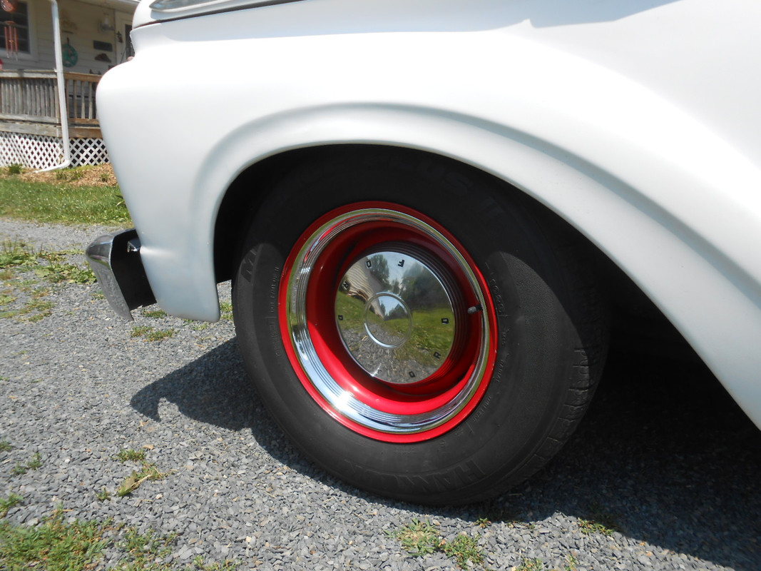

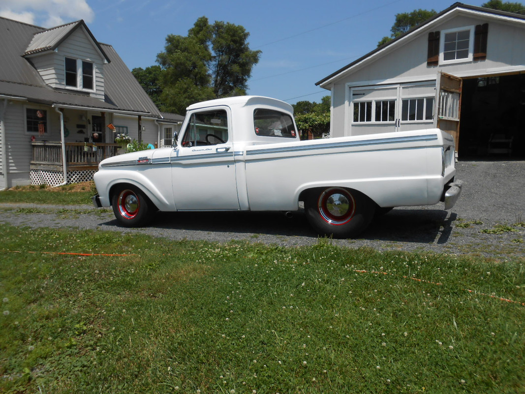

I have a set of used tires on the rear...they are 265/70-15. I am shopping for new tires and considering going to 275/60-15. From the tire comparison chart the 275's would be almost 1/2" wider than the 265's. I think that they would fit in the wheel wells. The tire shop had difficulty getting the 265's installed....they had to jack the truck way up in the air to get the axle to drop down far enough to get the tire in there. The 275 is 2/3 of an inch shorter than the 265. I have read on here and on the Facebook threads where guys have run the larger size tire with no problems....so, I will probably go with the 275's. I have always liked the look of a full wheel well...Anyone have any feedback on this?

The extra width will make them even harder to get on. You may have to jack the axle down to get them on.

ive got 2756015s on stock ford 7 1/5 wide wheels.mine go on and off pretty easy.

That's what I am thinking with mine. I ordered a pair of 275/60-15's for the rear and they will be here Thursday. I have a neighbor that works at a local garage who is going to mount them for me. I am not anticipating any issues....ratrapp wrote:ive got 2756015s on stock ford 7 1/5 wide wheels.mine go on and off pretty easy.

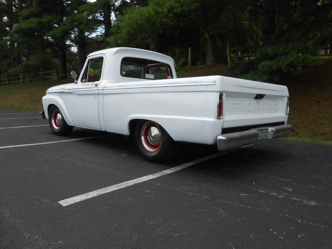

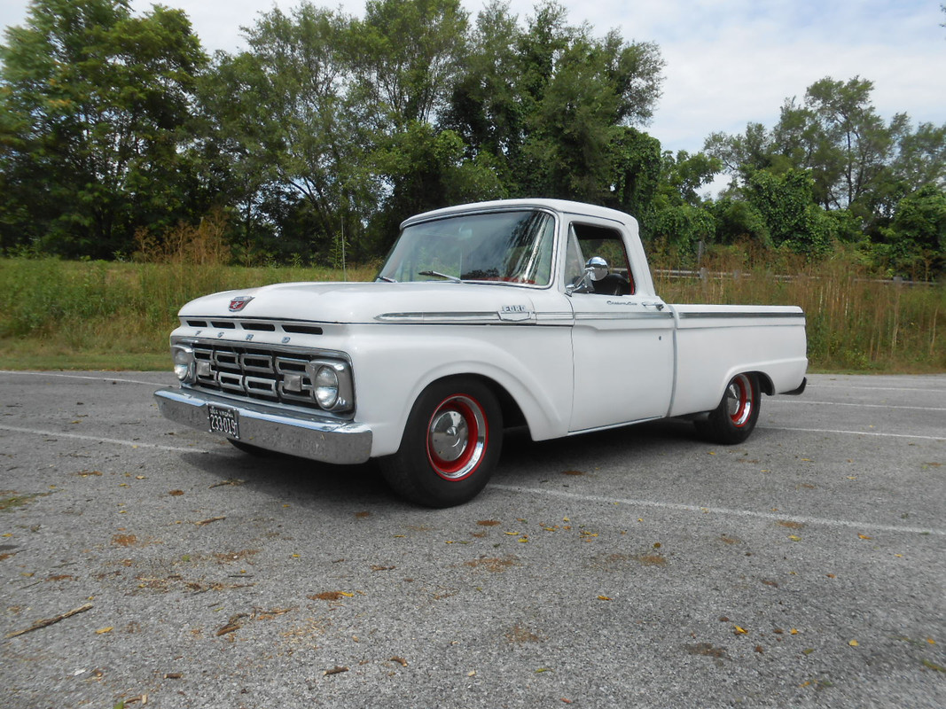

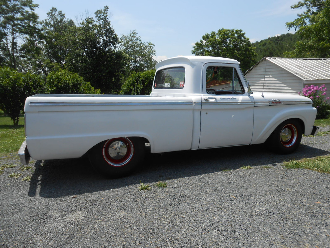

New tires installed...275/60-15's. They fit perfectly...just what I wanted. In going from 70 series to 60 series tires it seemed to lower the rear just a little. I love it!
I am thinking about going from 235/70-15 on the front to 245/60-15. A little wider and a little lower....we will see...

I like the drop to Steve. You got me by about 2 1/2" front & back
. You seem to have found it!
Seems like ALL vehicles have that imaginary line where they look GREAT, but if you go 1/2" past that line (whatever it may be) it will look like Fido's BUTT.
Yep you found it.......cool.

Thanks! It's been a journey...lol. But I agree, I finally got it about perfect. Still considering 245/60's for the front. The two tires on the front are 235/70's with a lot of thread still left. I'll drive it for awhile and consider what is next...oldsmiley wrote:I like the drop to Steve. You got me by about 2 1/2" front & back. You seem to have found it!

Glad you finally got your tires! They fill up the rear very well and the stance is right on. Good work. Hoping mine will have that nice of a stance

i'm running the same tire size combo you have.i wish mine sat alittle lower like yours does.ive only lowered mine an inch or so in the back with longer shackles and used the explorer springs in the front.a 225 70 15 might be another option for a front tire size as well.

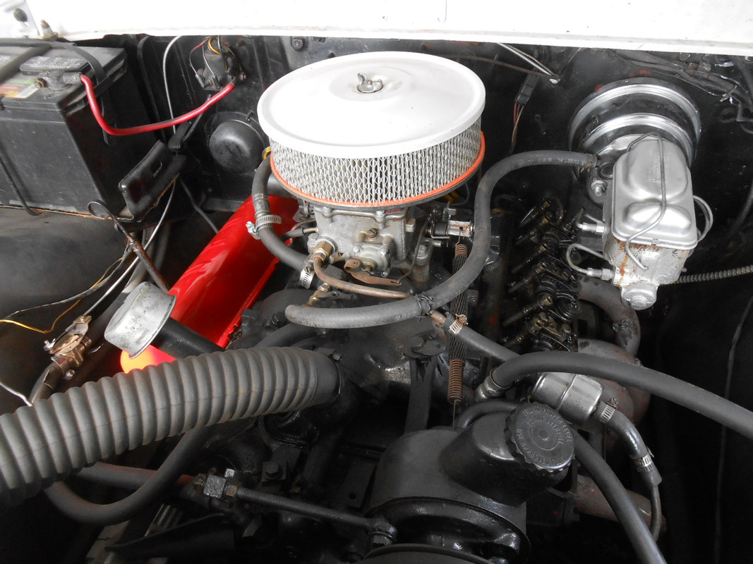

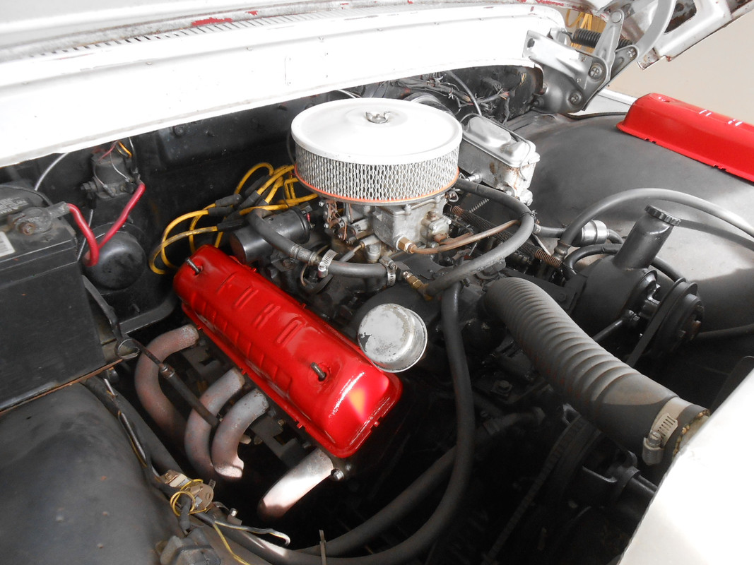

I had adjusted the valves a few months ago and thought that I could get by with reusing the gaskets. Not! They have been seeping oil down the side of the engine since. It's a mess under there! I will be close to Dennis Carpenters next week so I'll go by and pick up a set of Gaskets. Anyway, I've been wanting to go there and just check them out. Too bad I can't be in the truck, lol. The local auto parts place can't get gaskets for my 292 till next Wednesday and they would be $25.99...Dennis Carpenters are $12.99. Not to hard to decide...and either way I am waiting till mid-week to get them.
While I had the valve covers off, they needed repainting. I didn't have any black...so RED it is....and I set one on to see how it would look...
With the Jaguar IFS you can add spacers under the plate that holds the coil spring in place to get additional lowering. A 1/2" spacer will yield about 1" of lowering, so I am considering doing such. I might also tweak the camber just a little...the tires seem to be angled inward to much at the top for me and there is a very small amount of wear showing on the inner edge of my front tires.
