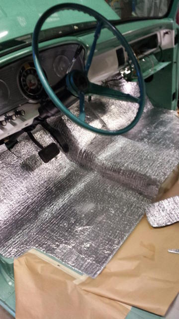

insulation and AC going in today. I like the look of this unit below the dash, and we've used it in another car so we already know it works really well. i suppose I could have hidden everything behind the dash, but I just like this look.
I got this insulation from here: http://www.lobucrod.com. seems like people like it, I'll let you know how it turns out. so far it's really easy to work with and seems like good stuff.
you may notice the green glove box door. Oops. I'll say that I gave it a green base coat to ensure it has the exact same tone of white as the lower half of the dash, sure, that seems like a good explanation.
