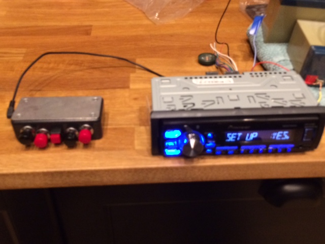

More interesting, made a hardwired remote for my radio. I plan to hide the radio ,a Pioneer MVH-X370BT, inside the glove box. From what I could gather online, it gets the best reviews of any bluetooth head unit. half the size of a normal radio since it doesn't have a CD player, half the cost too! I considered running just an amp and using a phone or iPod as the only radio, but volume control is nice to have. Sooo, the radio came with a plug for a hardwired remote. Got me thinking...a hardwired remote would sure be nice to avoid leaning over and opening the glove box to mess with it. The IR remote it came with is just silly, that would never work. I just made the four controls I think I'd most use: volume up, volume down, track fwd, track back, and source. I will hide the hardwired remote under the seat and shouldn't need to access the radio in the glove box much at all. As for the radio review, when it powers up, it auto pairs to my phone and starts playing via bluetooth automatically. Having the head unit tell my my phone to press play, for whatever reason, is something it seems most radios don't do. I like that feature a lot in my Ford F-150.
To build it was easy, just a series of momentary switches with various resistors to show the correct impedance to the head unit for the remote signals. About 2 hours and $30.

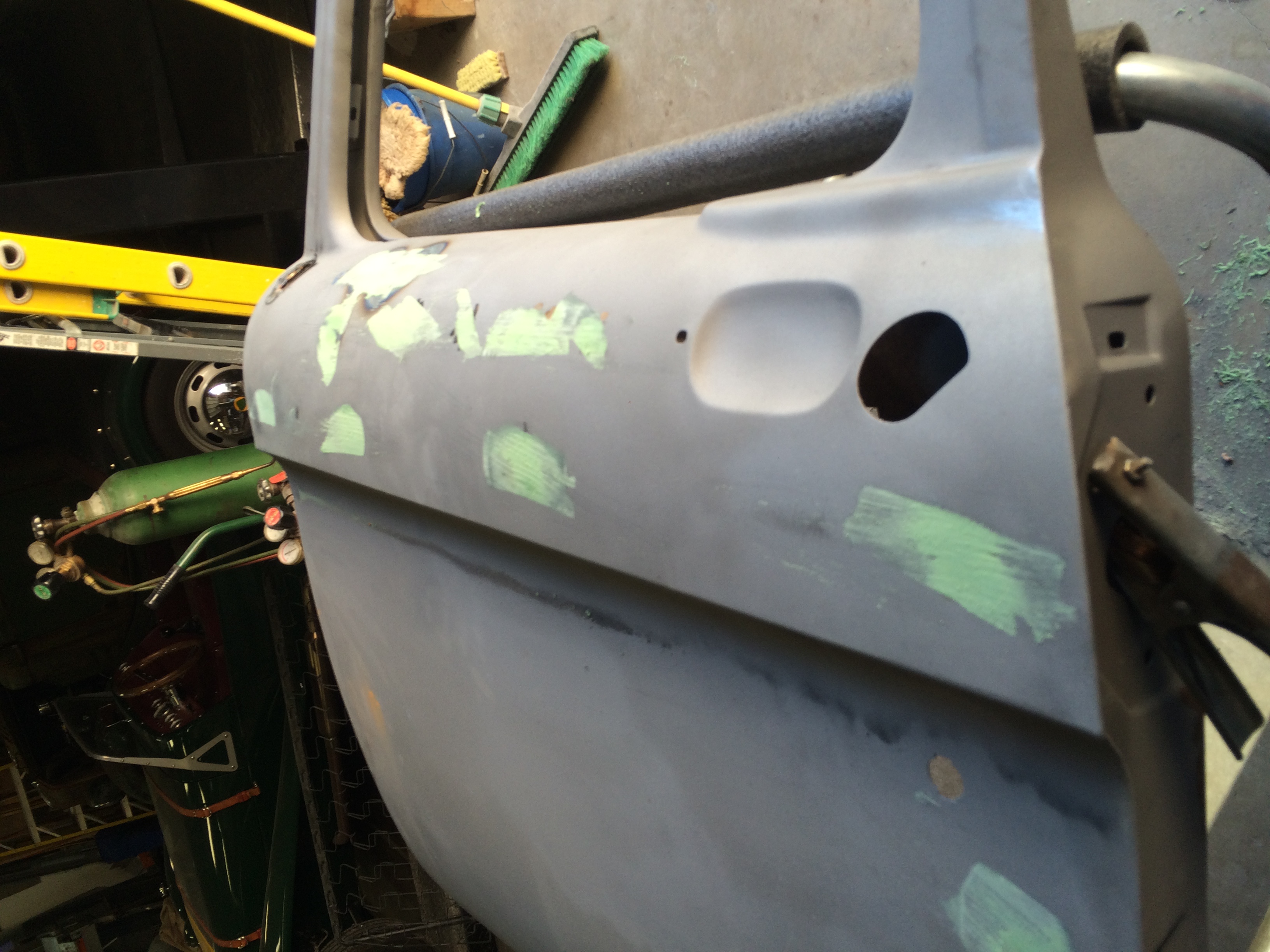

More sanding today. In the door photo you can see the benefit of high fill primer and block sanding. The blue circles are low spots i couldn't sand out. I filled them and it'll be primed again.
Tailgate is ready for paint. The hood has two more dents we found that need to be filled first....oops.
Getting there....slowly
