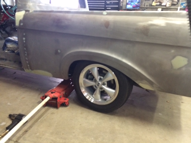

there's a reason nearly all of the slicks on CV frames have OEM ford bullitt mustang wheels. They fit, and they're super cheap. In the end, I got mine for $250 for all 4 including shipping. My CVPI wheels are worth nearly $100 each on CL, craziness. I got them from newtakeoff. I'd recommend them, perfect condition.
There are really only a couple wheels that will fit, that you'd even consider using. The American Racing VN327 wheels can be custom made to actually have the same or more pos offset than the CV wheels. While they're Cheby replicas, you can google the Gas Monkey 69 ford that had them. I saw it in person at BJ in Phx last year. They looked great with no center caps. I think they're about $4k or so for the set, maybe someday.
The stock CVPI wheels are ok, not for me. I considered trying to weld up all the holes to make them look like smoothies, but went for the bullits instead. I actually like them in person. I think they'll be just fine. Can't go wrong for the price, and they fit the stock tires so I can reuse the tires I already had. score.
These wheels stick out 1/4" more than the stock CVPI wheels. I had to roll the rear fender lips to make them work. you can even remove the rear wheels without some terrible process, nice. they fit.

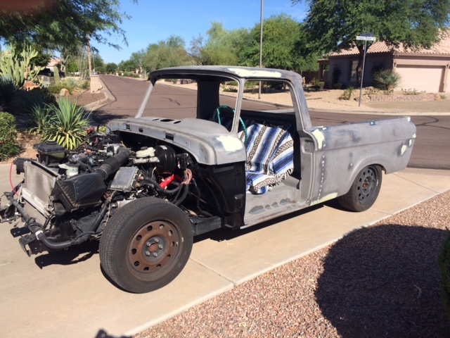

with the body back on, it runs!
amazing how nicely it drives. I guess it makes sense, since it's all 2008 family sedan parts. really works great.
