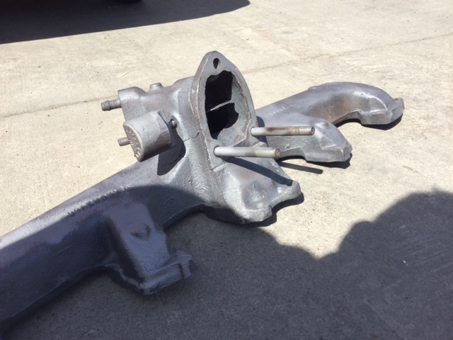

I'm not familiar with welding cast but I think I might need to just buy a new manifold here.

Why not try if you're going to replace it anyways? The key to cast is to pre-heat the metal.
