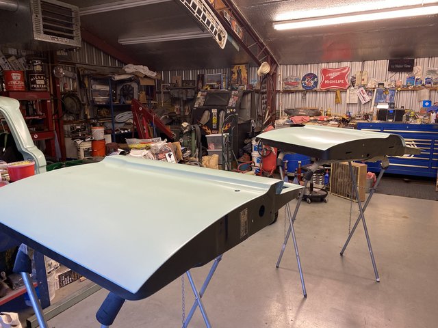

Well after some patch work, the doors got painted. Didn't get any action shots of the repairs but wound up replacing quite a large section of the outer skin and more of the door bottom that had previously been worked on.
Thanks to my lovely wife, the doors got hung and pretty much aligned. I didn't do enough fitting before taking everything apart, plus so much of the lower part of the cab was missing (i.e. RUSTED!!!) Had to rig up some pull points and a come-a-long to get the tops of the doors "adjusted". I think they're going to be just fine. My neighbor came over and looked them over. He used to do bodywork and said they were as good as he could get them without doing some metalwork and repainting them. Got the right fender on and hopefully will get the left one on this week.

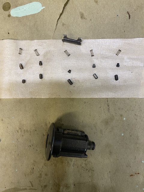

Started putting the internals back in the doors and discovered the key didn't work. I decided to rekey the door locks.
Does anybody have instructions for putting this thing back together????
Just kidding, got them done and started on the driver's side. I fought that lock for many hours over several days. It would lock but unlock when you turned the key back to neutral position and vice-versa. Finally pulled the passenger side parts out of the storage bag and there it was, the little retainer clip that holds the cylinder rod at the latch was missing. Nowhere to be found in the parts pile. I did find an extra for the passenger side but wound up stealing one from a spare door. Now to get the windows and weatherstripping put in it.

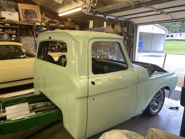

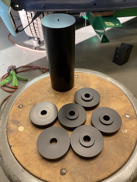

Well it has come to my attention that the cab is sitting too high on the frame which doesn't allow the bumper and lower valance to line up. Too far in to do any metal surgery so decided to do a body drop. A buddy recommended delrin and cut a set for me on his lathe. Got them in last night but ran out of time to put the valance and bumper on to see if my measurements are going to come out right. Here are the new body mounts:

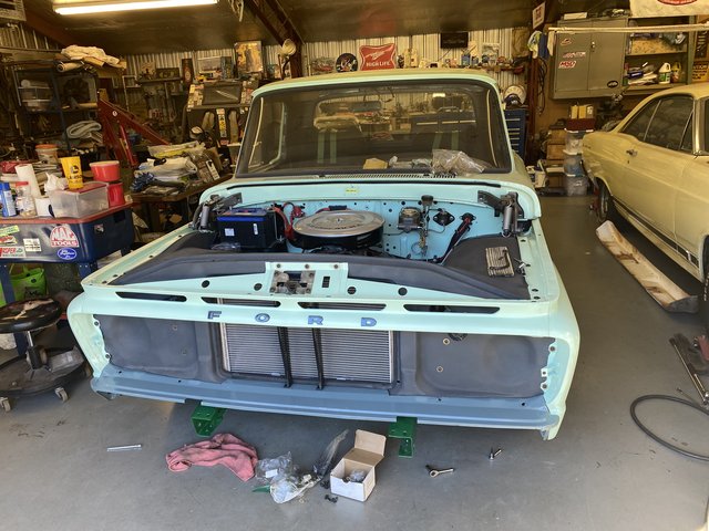

Well the new cab mounts appear to be just the ticket. I did stick the bumper on and the clearances are much better. The bumper needs some more tweaking. It was hit pretty hard on the driver's side and I was able to get it fairly straight, but it still has a twist in it. Got a strap wrench and the torch out a few days ago and from my rudimentary measuring the twist should be pretty much gone. Haven't had a chance to try it again thanks to this company I work for. They think I have nothing else to do but spend the majority of the day doing stuff for them. Lots of overtime last week which helps pay for this project though :D
Here's what it looked like before working on the twist:

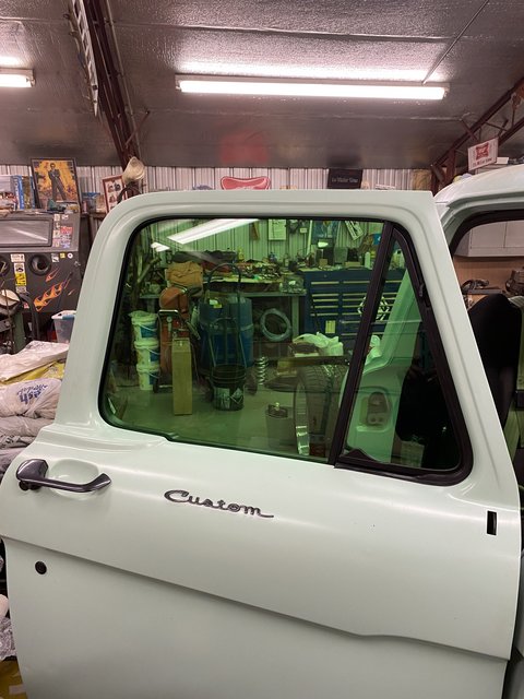

I also have been cleaning up the side and vent windows, trying to get them ready to put back together. Hoping to do them all at the same time because I'm going to set the glass in the frames and lift channels with urethane. Did that on the 65 and was very pleased with the way they came out. Shouldn't have to worry about water settling into the vent window frames again. I didn't enjoy using setting tape on a truck I helped a friend do a few years ago.

Wow, the Delrin pucks are cool, have to tell me where you got the cylinder. The pucks still look like they are 3/4” thick… how much difference between those and standard cab mounts ? Truck is looking good.

The delrin came from amazon. They are actually a bit shy of 1/2" thick. I wanted to have some extra adjusting room and with the factory washers on top, they're right at 1/2". I'm still puzzled as to where I mis-measured or whatever and couldn't use the factory isolators, but these will be just fine and hopefully not cause any issues down the road.
Haven't made much progress the past few weeks. Had some home projects and a couple side jobs to get done. The side glass is ready for tinting whenever I get time to clean a space out and not get in a hurry. I did straighten the lower left part of the grille out this week and was going to test fit it. Realized I had picked up an extra 65-66 stone deflector that was in the shop, blasted it, epoxied it, and basecoat/clear coated it. Holes don't line up!! Found the original one last night and will have to do the same things to it, PLUS a lot of bodywork!! Glad I bought extra white paint :D

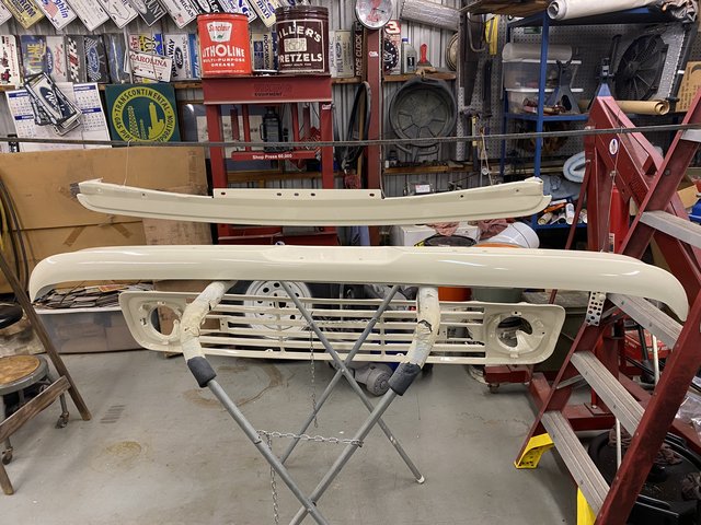

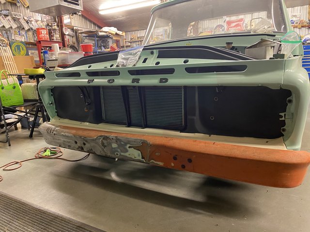

Well, the weather has really cooperated here lately and allowed for the grille to get blasted, bumper stripped, correct stone deflector ready and all of it primed and painted as of last Friday. Got the stone deflector semi-mounted this evening, ran out of bolts. So that means blasting and phosphating bolts tomorrow hopefully. And probably a week or so of masking the grille off to blackout around the headlights and make the "floating bars"!!
This was late Friday while these parts were still drying after moving them in the shop

Looks good man… interested to see how they look with the green. Is that Wimbledon white ?

Yes, it is Wimbledon white. Actually, the mixer used Corinthian white because his book didn't go past 1968. It did take a week to get the grille blacked out, but only about 6 hours to tape it up :roll: The bumper and stone deflector are mounted and got started bolting in the grille. Need a few more u-nuts so planning to dig through storage containers sometime this week.

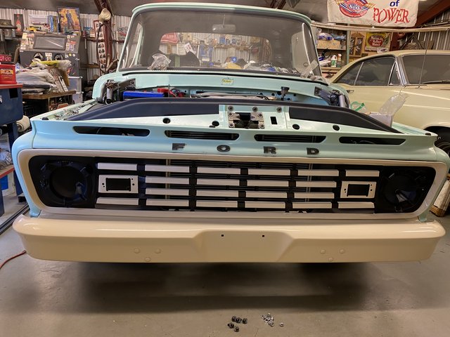

Not sure why the photos didn't attach last night, but here they are, like me, always a little bit behind!
I'm really happy with all of the colors. I wasn't real sure about the gloss on the white parts but one of my buddies that has painted for 40 years said it will stand up better to scrubbing bugs off of it if its glossy. It turned out to be a nice contrast with the flat clear green on the body. I hope there will be lots of bugs on the grille of this one soon!

Man, what a difference the grill makes… I think you nailed the floating bars.

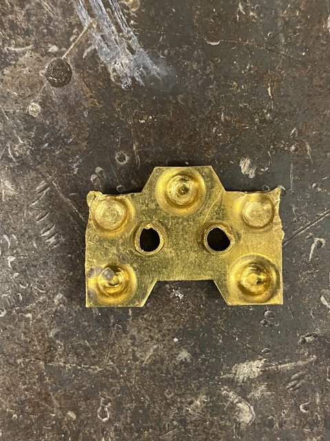

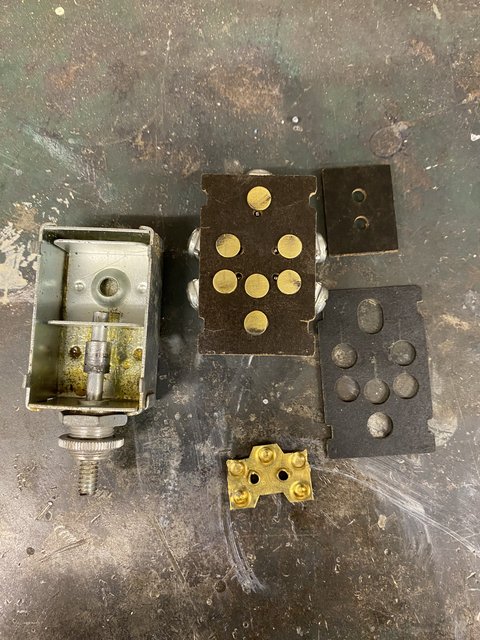

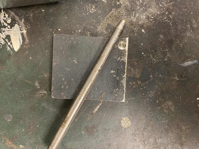

Here is the switch when I started:
After disassembly: (And it really was this clean inside!!)
The movable contact that got an extra nub on the lower left corner:
Homemade contact modifying tool :D

I've forgotten how much "fun" it is putting the glass back in these things! Spent a few evenings last week on the passenger side door. Put this piece in, take it back out so this other piece will go in, and repeat again and maybe again, again. I need to write the order down for the next time!! I've always had a thing for the old colored plexiglass windows in drag cars and customs from the 60's so this one got green. Need to get the drivers side finished and hopefully I can talk my neighbor into helping put the rear window in sometime next week. And the vent shades are waiting to go home too.

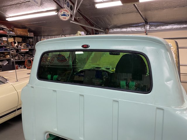

Well she's "dried-in" now. My neighbor came over the other night and saw the back glass and asked why it wasn't in the truck. I told him I just hadn't had time to get it in. (Couldn't tell him the truth, that I was scared to, gotta keep a good face you know!!) He asked if I had any rope and ten minutes later we were admiring his skills :D

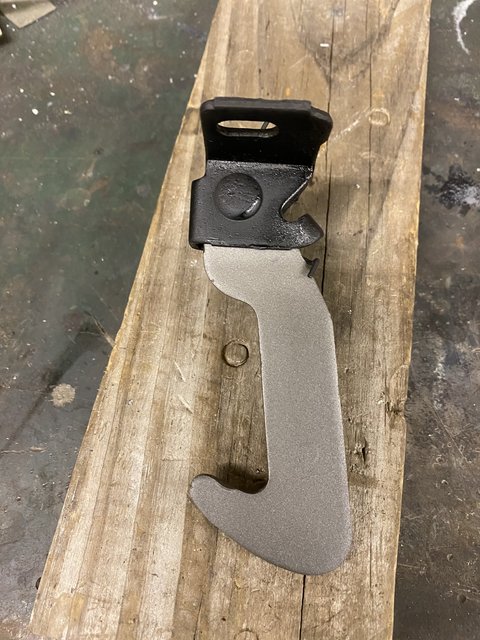

Amazing how quickly the days can pass! Haven't made much progress on much of anything in those days except I did get the hood latch and safety catch installed. Had to replace the spring on the safety catch. The leg that hits the hood was broken but found another spring on an oddball catch that I'd picked up somewhere. (Guess it's not really an oddball, it just isn't for a Slick!)
Before:
After replacing the spring and a few minutes in the blaster:
