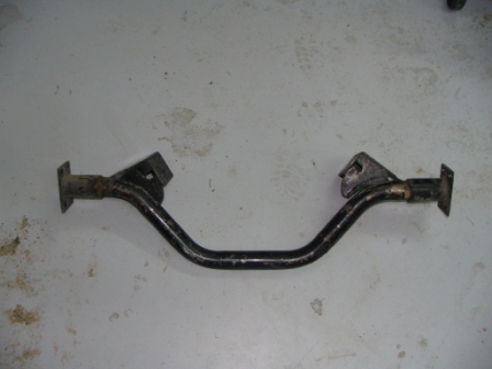

Next you will need to get one of these. This pic is from LMC but there are a lot of univeral 429/460 cross members.
[albumimg]5861[/albumimg]
If you want to run headers Sanderson has some shorties that fits the 64. The biggest problem with headers is clearing the steering box....

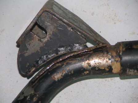

When you buy your univeral cross memeber just be aware of the cheaply built ones. I had this failure and it was not fun... Nearly pushed a mustang into an intersection because I hit the gas with brake on and the motor toqured up and jammed the thorttle.. Not fun by any means good thing that mustang got out of the way and the motor went to normal postion...
