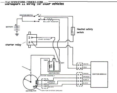

This might help
The key is the soliniod "S" and "I" Terminals
You need to run the Start position of the Ignition switch to the "S" Terminal.
Next "I" Terminal to Plus side of the coil. This will also connect to the plus side of your distributor (Procomp). This will provide power durning start
Next Run position off the ignition switch needs to run directly to the plus side of coil, no ballast/pink wire. This will also connect to + side of procomp.
This will work
This will work

Re: need help on this guys...
I just dont get it and I am about to loose my mind...
Now on the switch both switched and non switch shows 12 volts.... (No jumpers connected)
Also the coil get no voltage with the pink wire hooked up and it starts to get warm...
Yuo've got some wires crossed. You are feeding back from the coil primary to the (s) terminal on the solenoid. Your resistor wire is not feeding the coil once the 12 volt starting boost is removed, thus the engine dies. The wire on the (I) terminal of the solenoid feeds 12v to the coil when starter is engaged. It will actually be less than 12v because of starter draw. I haven't followed your entire post due to other activities, but, return the wires to where you had them originally , then probe the coil + terminal after removing the heavy starter wire from solenoid and with key in start position. You should have ~ 12v. Release switch to run position, you should then see ~7v at coil. If your Distributor requires a full 12v, eliminate the pink wire and replace it with a regular wire from switch to coil +, leave the (I) wire disconnected at the solenoid. You will then have the needed 12v at all times the switch is on run or start.The pink wire probably does not go to the coil currently, but junctions with the wire from the (I) terminal in the harness . Run your new wire to the same point, but make sure the solenoid (I) wire remains disconnected.
Hope this helps,
Paul
Hope this helps,
Paul
The Ford Orphanage
Life's too short for boring vehicles!
My quest to develop a universal solvent is held up by the lack of a storage container.
Paul
Paul
UPDATE:
I beleive in his situation he only wants the start position of the ignition switch to the s terminal on the soliniod. No where else.
"I" terminal does not need to be used
The the run position ignition switch (no Ballast) to plus side of coil. He has a GM style ignition. 12 volts right to module also connected to plus side of coil. I beleive the run position ignition switch is hot in the Run and the start positions.
Right now he is using the start position to power his ignition. I would just runs a new wire. well two new wires.
Or make sure coil is powere from 'I terminal on soliniod. And Run position of ignition switch. COIL SHOULD NOT BE CONNECTED "S " terminal of the soliniod.
Cwin This might be real easy, do not get discouraged.
Try this disconnect the wire from the "I" Terminal on the soliniod. See if the truck starts.
If it does not start. Connect a wire from the run position on the igintion switch to the wire you disconnected from the "I" terminal. No not hook the wire back to the "I" terminal. Do not hook it back up.
This is what Toyz said.
