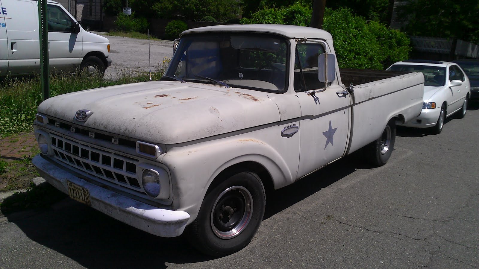

hey all,
i just picked up a 65 ford f100 with a straight 6. 300 ci engine.
i bought it from a friend who had sold it to a friend years ago. the friend rebuilt the engine, and the carb crapped out on him so he sold it back to my friend.
ive never had a ford with a straight 6 before so any suggestions on this carb would be great.

BiffTirkle....sounds like a NASCAR driver:):)
Looks like you got a solid truck to start with!!

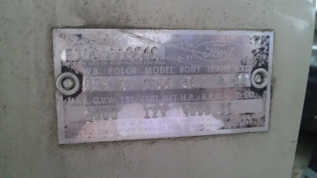

thanks john! i appreciate the offer! and now im wondering if i made the right decision.
someone on here, i forgot who sent me an email with a link to an ebay listing for a set of 3 manuals. i bid and won 35 bucks for the set.
i hadnt checked this thread in a while and of course now i read your post about making sure my vin matches the year.
here's a picture of my warranty plate.
from what i could find, this truck is
f100 2wd - true
had/has a 240 ci
assembled in Norfolk VA (which is funny because i am not 2 hours from Norfolk)
i still cant find production year. seems like finding a vin decoding chart for this truck is more difficult than it ought to be.
i also posted a pic of the engine #'s, from what i can determine this is a 300ci engine. which would make sense. someone did a trans and engine swap.
sooooo.... any help identifying which year this truck was made and confirming which engine i have would be much appreciated.

Biff if the 3 book set you bought is the service manuals. The first book of the three should have a complete vin breakdown with production #s listed. It will have a very complete breakdown about what all numbers on the vin or warranty tag compute to. I did notice that the chrome fender badge on your truck on the drivers side is the one for 66 not much help just something I noticed.

That was me that spotted the set and pm'd you so you would have a clear shot at it.
Sure hope the set fits the vin.

everythings good. i got the right manuals. woo!!
manufactured in Norfolk VA in august '64 shipped to richmond for sale. originally red in color, 240ci 6cyl 3 speed standard duty trans.
